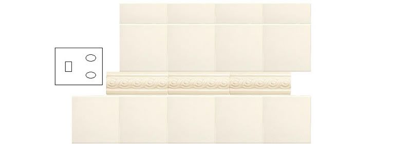

We're looking to install a ceramic tile backsplash. AFter much deliberation we chose to use a plain 6x6 on the bottom with a 3x8 listello above, another 6x6 above that and then will in the gap. My question has to do with the installation around the electrical outlets. The listello piece is thicker then the tile and it will be the same height as the outlets. How do I get the outlet covers to lay flat on the tile when the 6 x 6 pieces aren't as thick? Here's a diagram of what I"m talking about with the outlet on the left. DOe sthis question make sense?

Move the electrical boxes, or adjust the tile layout...

Yep, what Jim said. Those deco pieces make it hard on the outlet covers. They never look nice.

Move the box. being as you will be setting tile over where the box was you can put in new piece of drywall or use one of those drywall hole patches.

Yikes..but it's not just one outlet.There's 4 along the way. Darn, I may just try to re-design the backsplash then. I don't really want to get into the electrical stuff.

Move the rope up between the 2nd & 3rd tile or if there is a 4x4 in that tile use them for the bottom row Then the rope and more field tile 6x6x or 4x4

You don't have much choice. If you leave the box and layout like it is, you violate the NEC (National Electric Code) because you won't be able to install a cover plate flush with the box.

We usually just lower them, it's not too hard, and usually there's enough wire,although we have had them faux painted,and they usually do a good job.
