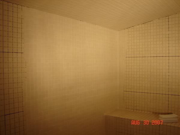

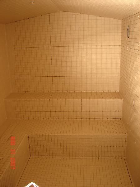

Okay-- here's this week's pictures, complete with the grouting started. I just found a new favorite part of the job-- Spectralock on the CEILING!!
Actually, it wasn't half as bad as I expected it to be. Ended up trashing the shirt and ball cap at the end of the day, but atleast I didn't have any problems with it coming back out of the joints on me!!

huge difference in quality...in reference to the workmanship AND the condition on the jobsite......
Your 9235 shows very little thinset marks from your hands while the "other" steamroom has wipes all over the walls and floor. I was amazed at the cleanliness of your work area....hardly any thinset residue anywhere to be found, and that says alot to me.
Also, the first pack of cigarettes found on site laying on the floor would have been that crew's last day on the job around here.....not to mention they worked like a bunch of slobs....nice touch on the chair too. I'm guessing it was made for a dual purpose of smoking lounge/ladder for the ceiling ...

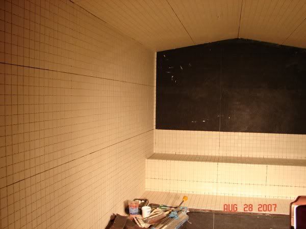

Yup, the chair really sets apart the Billy Goats from the Nanny's, don't it. The mess all over the walls and floor are only part of the problem . Did you see those bubbles under the membrane in the #3 photo?!?
I give that room about a year of use before it starts to develop "issues".

I'm not sure what that is-- shadow, or a light film of thinset-- but there weren't any bubbles under the membrane once we were ready to start tiling, and I did look for them, because there were a few right after putting the membrane up that got patched. As for that chair, that was actually pulled out of the dumpster to be used as his kid's computer chair. It WAS a good chair!

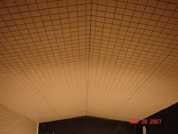

I'm pretty sure I'm seeing some horizontal "pillows" under the membrane in the #3 shot, and the same shapes appear in the #4 shot also, so I don't think it's a reflection. #3 shot, along the bottom edge there is a horizontal ripple with a branch breaking off the right-underside. It's repeated along the lower left-edge of #4. I saw a few others but that's the one that's most clear in both shots.
But you were standing nose-to-nose with it, so if you're certain I'll promise to get my glasses checked.
Shaughnn
