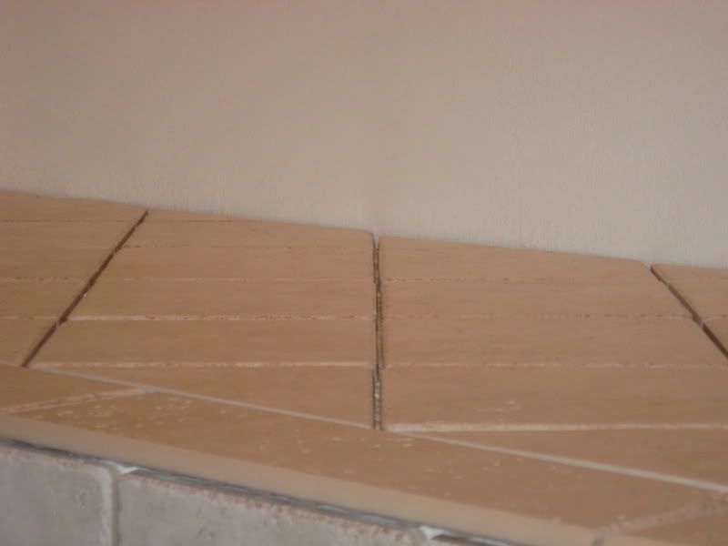

Okay I've been testing my tile with a key and everything seems to be in order for now. But after close examination, I've got another issue: some of my lines are not perfectly straight. I'm what many would call a perfectionist and tend to worry over small things like that. Here are a couple photos to show the area in question:
The lines are toward the center of this photo
Showing the worst line
View of entire countertop
What is your opinion on this installation? Is this something that would pass in the industry or that a decent (or maybe amatuer) installer would deem acceptable. This irregularity barely shows if you view from the top and only really shows if you get down level to look at it.

Posts: 26,510
Grout it !
it looks to me like your tile is of odd sizes.

It would pass in Florida.
WhatBrian said. Your tile look like it's different sizes. Grout with a color that matches.

that tile has a beveled edge also and will need to be sponged out slightly, second nature to us tile setters.
