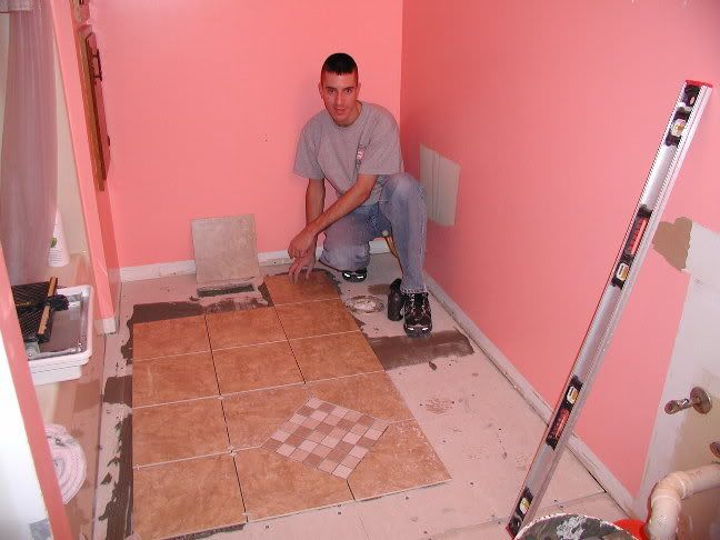

After finishing that, I was exhausted. I got some much needed sleep and at 9 in the morning I was ready to start tiling! I set my Felker TM-75 up in the tub with a quickly made brace and hooked up my new hot dog blade(well worth it, like butter!) The tiles are some cheap tiles from Lowe's($1.59 sqft)

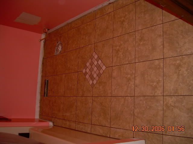

I wanted something to break up the simpleness of the floor, so I opted for these three listellos placed side by side in the center. I think it turned out great, and worked out faster than I expected.
I finished tiling by 2:30 pm and let the tiles set up the rest of the day.

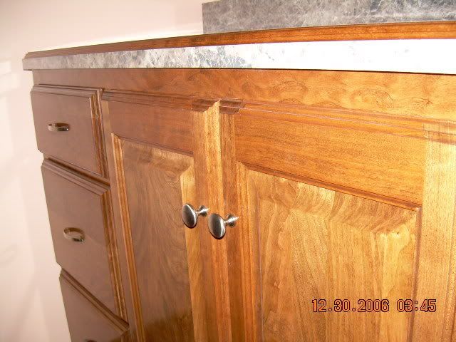

My new Toto Drake toilet will be here Monday morning, and my father just finished my Cherry vanity that he built for me(this is now my nicest piece of furniture I have). For all you cabinet gurus out there, this is some quick pics of it sitting in my kitchen. Cherry with raised panels and a laminated top, and has a nice Kohler sink for it. The deep drawers and dove tailed and have nice little partitions in them for all the wife's "stuff". It is 61" long and 22" deep, and 37 1'2" tall. The price was even better, I just had to cover the materials and wait a month for my dad to get it done

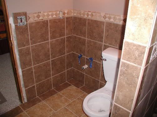

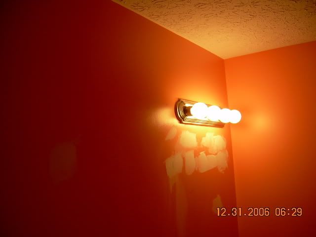

To answer some questions. NO we are NOT going to keep that color in there. It was a quick pick that the wife picked out last year when we moved in. And yes, now she is officially not allowed to pick paint color I am going to paint it a chocolate color, the exact paint as in my other bathroom. Here it is above the tile in the earlier stages of the first bathroom:

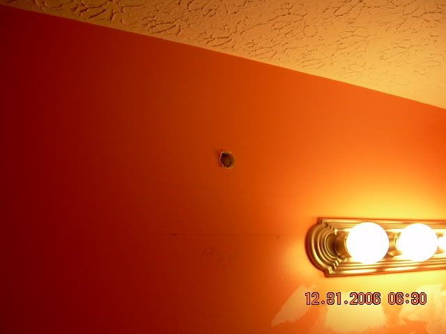

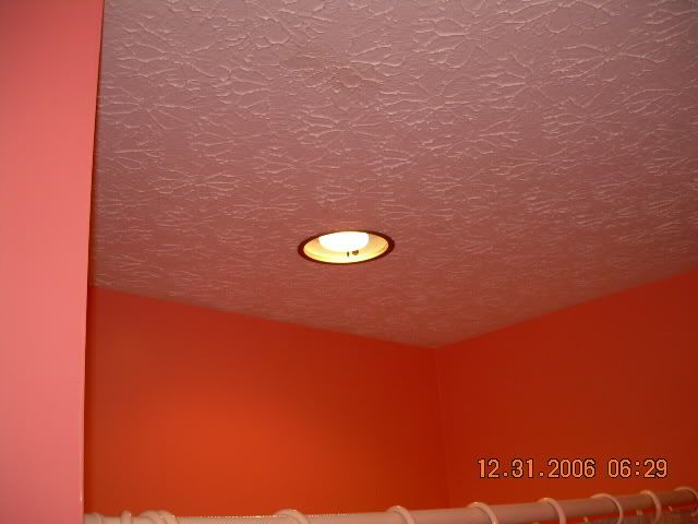

Anyways, here is what I did today. I have never put in a recessed light, so here is my first attempt at it. Getting it installed was cake, running the wire from the attic through the studs between the drywall and into the back of the existing electrical box, was, well.....next to impossible.
And I also figured out where the new vanity light will have to go, so I went ahead and made the hole. Tomorrow I am going to try to get it re-wired in the new location(to get it centered up with the larger vanity)

recessed light
Mike - looks like you installed that recessed light over the tub, right? If so, make sure that fixture is rated for a wet location. Also you'll want to ensure that the breaker that feeds that electrical run is a GFCI breaker. If you spliced it off an existing light switch then it probably ain't...
