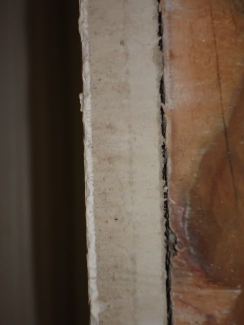

Hmm, if it's sound why not just tile directly on the old plaster? (wet shower walls excepted of course).
What paint is 1/4" thick? I don't understand this unless you mean popcorn type stuff, which can be removed with water.
- DL
here is what im talking about
the wall seems to be made of sheetrock, the layer alway to the right, plaster, the layer in the middle and a paint layer, top white layer.
dosent come off very well with water. and the stuff was just peeling off like really thick paper on the ceiling.

i was just trying to see if this type of wall construction is normal? and what the "paint" layer really is, is it paint? DL said that he didn't think that there was actually 1/4 inch of paint on the wall, it actually measures in a just a hair shy of 1/4 inch. i was just posting a picture to prove that I'm not hallucinating. but at the same time, i don't know what this layer is (the white layer) or how it was applied.
me being a curious person, I'm just curious if anybody here has run into this before.

I'm guessing that the white layer is a finish plaster layer. The walls in our ~1940s home are similar, but the dimensions are less. I think we have about 3/8" of some type of wallboard, covered by two layers of plaster (white over gray). The two layers of plaster together are about 3/8". If the plaster is not water-damaged, it should be quite hard (much harder than drywall).

hey, i think your 100% correct, thanks for the insight!
you are right, it is quite hard and well bonded to the wall.
I ran into a similar thing in my basement and chipped out the peeling outer layer then tiled over the existing wall. that was 2 years ago and it is holding like a champ.
needless to say, i thought it was paint (at least some form of lime whitewash) then too.

That's typically the thickness of hardcoat, but they weren't using it back then, so i'd agree it's a thin plaster.And don't believe that crap about Mike fallin off the wagon.
