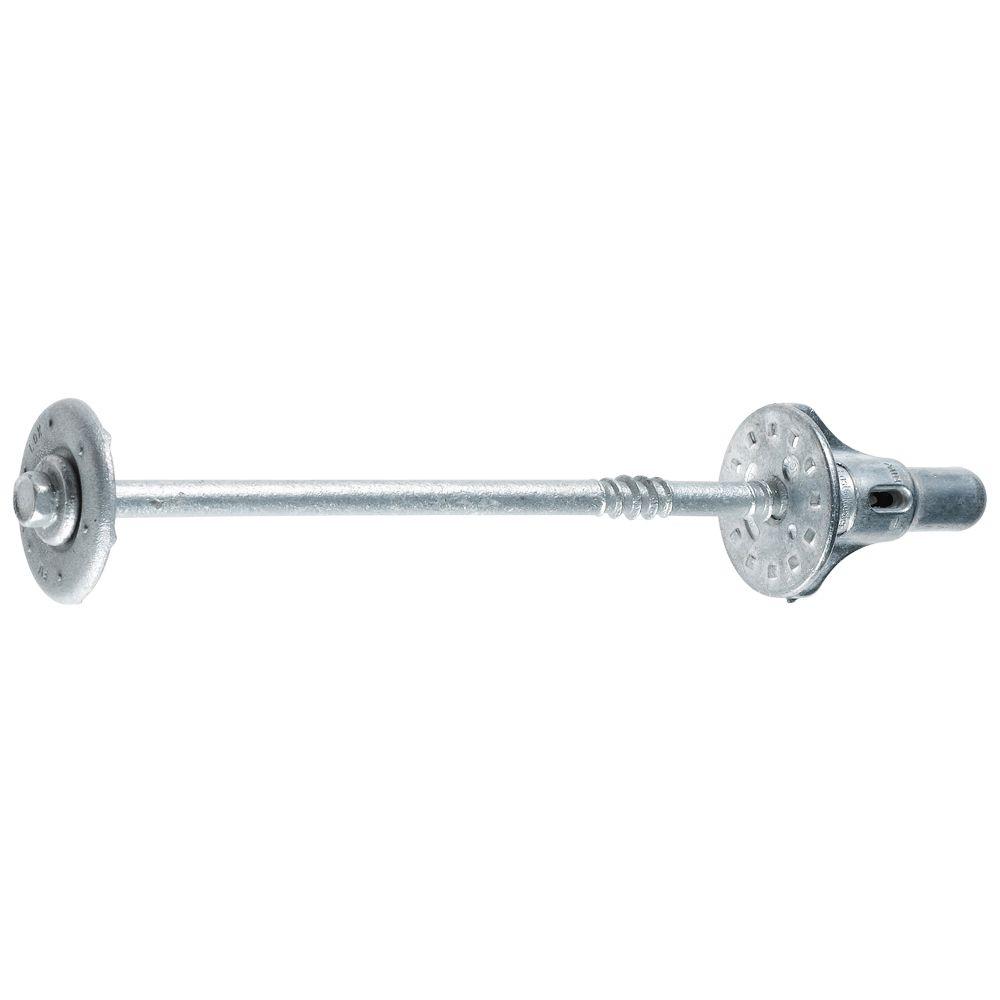

Use threaded bolts (not lags or carriage bolts) with washers on each side.
Dan, did you mean threaded rod? The idea of drilling 3/4" holes through that joist scares the crap out of me. Or is the wide curvature intended to reduce stress and stop cracks?
I was eyeing these Fastenmaster thrulok's: https://www.homedepot.com/p/ThruLOK-...INDY/204307982 Self-drilling fastener and washers all in one.
I'd probably still pre-drill but they're a bit less than 1/4" thick.
Even with the washers, I'm worried that the fasteners will crack the dry joist. That was why the 1x8. Or would it be pointless as an extra layer of padding?

Then use more, but 1/2" bolts and nuts. What I like about the heavier duty hardware is you can tighten it much more which will draw the faces/grains of the 2X's hard against each other.
Honestly though, I don't think you'll have a cracking issue. I had to bolt together 5 sets of 40 YO 2X10 joists very near their ends for my bathroom project not a single one cracked or split. Don't have a clear picture of the my 3/4" bolts but they're right where the joists lap each other.
And like Wayne says, you're effectively taking that cracked 2X out of the picture as far as it doing joist duty.

Something like this? https://www.homedepot.com/p/Crown-Bo...0680/100147536
My joists are 70 years old but I get what you're saying. I'll use big washers.
