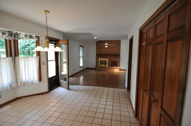

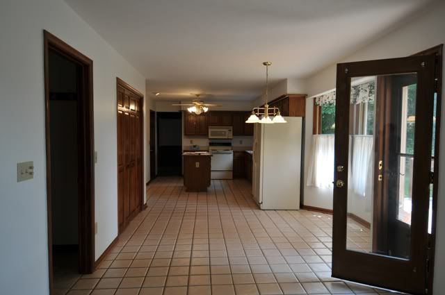

We'll it's been a while since i last posted but I'm back! My wife and I are buying a house in Dayton OH and with that comes a slew of new projects one of them being new kitchen tile. So on to the questions.... What is the best way to break up tile over concrete slab?
Yummmm 6 inch pink/beige goodness
I have a hammer drill with a 3-inch blade that i used to bust up a broken tile but that would be very time consuming for the whole kitchen.

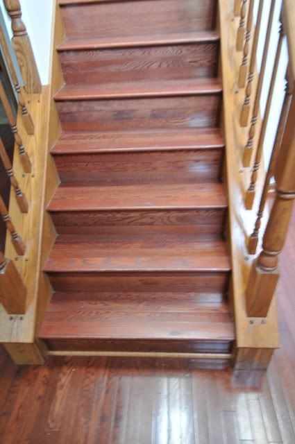

Off topic: Anyone here ever refinished 5/16th solid wood floors before? Can i or do i have to replace them (they don't match the trim cherry wood floors and medium oak throughout the house)

Hi Nick,
Whattsa matter with that tile?
The easiest way would be with an air chisel. You can rent one at Homer's for a reasonable price. I think that would be the quickest way to go and less effort as well.

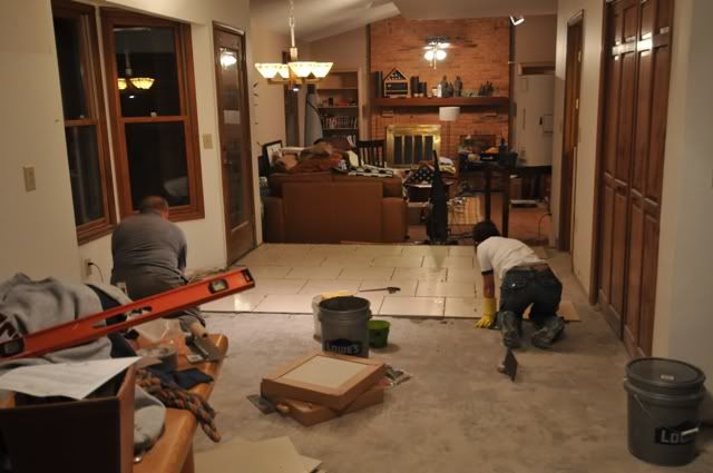

Quick question: What is the rule with diagonal tiles? Does it make a space look bigger/smaller? Would it look good in a long rectangle kitchen?

I think the diagonals look great in a room like that. You're on the right track in that photo--> lay a bunch out and see how you and your wife like the looks of it.

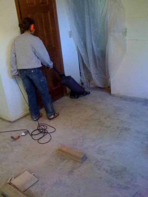

Q: So what do you do with a 1000$ vacuum when you buy a house that has no carpet?
A: What any reasonable man would do, use it as a shop vac! This is the wife prepping the floor with a Kirby. The Lowe's 30$ special just doesn't suck enough.

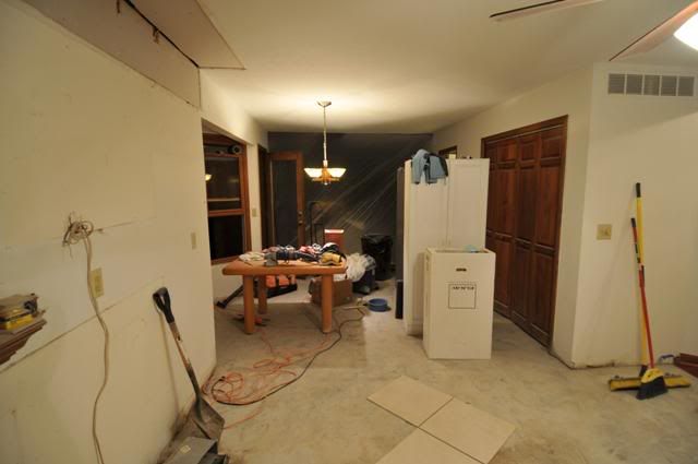

Quick question:
We are starting to lay tile the line that I am most concerned about is the transition from kitchen to the family room as seen in the pic above. I have started from the center of the room and laid out some tile to get a rough idea it looks like i will be left with some small pieces. Is it ok to start laying fro this line and work my way to the other side of the room?
The rest of the room has cabinets or small wall space and i really don't care if i have some small ones near the cabinets, i think this line is the most important.
Thanks!

It is fine to start at the transition. I like to start this way, people are more likely to notice the transition from one room to another.

VW freak what kind of wood is that on the staircase. It looks very very yummy from here kinda like pecan. yes you can refinish it dont have to replace it. I like stairs with wood threads and with white risers. or you could kick it up a notch and tile the risers..

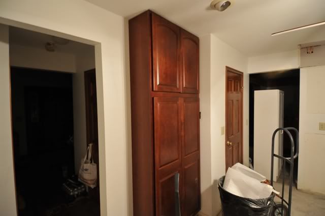

And a preview of the new cabinets (had to put this one up before tiling because there is only a 1/2 space between the top and the the ceiling
