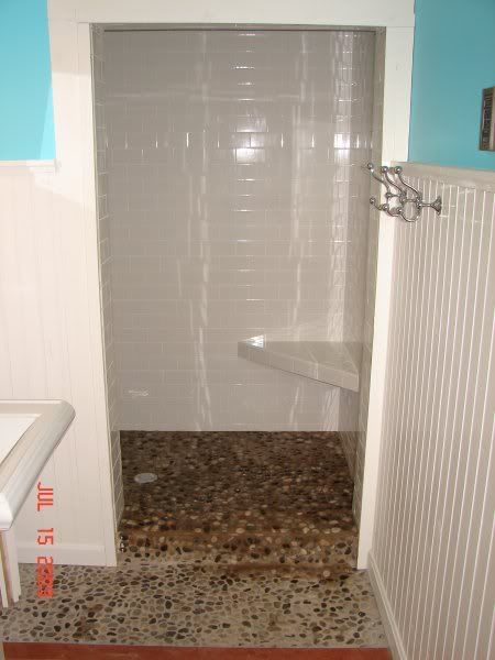

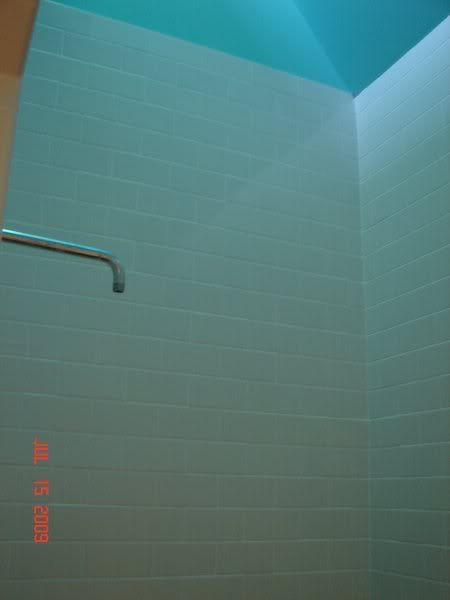

I wish I'd thought of this thread a few weeks ago. One of the showers I just finished was an abortion that someone else had installed, and done a terrible job. Imagine this-- the shower's 3 1/2'x7'x 9 1/2' high. Subway tiles on the walls, and a larger (2") river rock on the floor, curb, and right outside the shower. Doorway's all the way to the right, and it's a walkin, with an 8" return in the doorway. First, the doorway was trimmed in raw pine 1 by's, and tiled directly over with premixed thinset. The rest of the shower walls were also set with premixed thinset...... over 1/4" hardi (they told the contractor it was just as good, and half the weight). The tile was so out of wack, that there were places where one tile would be so far out from the one next to it that if it weren't grouted, you'd be able to see the back of the tile. The contractor had tried to save the river rock, even though all you could see were the very tips of the stone. It looked like rocks sticking out of the surface of a pond of grout. I told him no way, though, when I saw the Chloroloy stuck up only 1 INCH over the surface of the shower floor. It didn't even REACH the top of the curb. Good thing I did that, too. When we pulled the pan up, there were several places where this moron had punctured the Chloroloy, and then patched it with DUCT TAPE. Oh yeah-- one last thing-- they had a wood framed corner bench, covered in plywood and then 1/4" hardiboard. The guy told the contractor the hardi would protect the bench from the water.
I mean, it was BAD. Here it is, the second time around:
Edit-- One last thing-- the dry area of river rock-- that's all that was left from the original installation, and that was the BEST of it.

bill that curb is awesome man. I take it no door. If we all keep doing good work like that we maybe can flush the hacks.

Nice curb Bill.
Now lets see...Cost of first install plus Bill's rip out/install plus buying the material twice. How much did they save with that low price to start with?

Actually, it didn't cost the homeowner a dime more. The GC, on the other hand, learned a valuable lesson. The last job I did for him was his own home, about 4 years ago. I believe he was rather upset with me because I was so "expensive".
Bill
