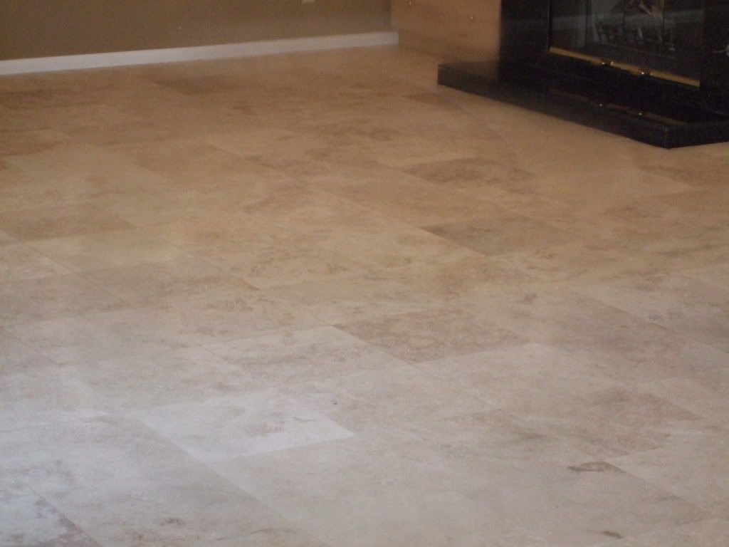

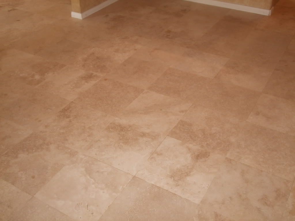

Diy gone bad
who woulda thought?
this is a side job Im doing, trading my chiropractor for disc decompression therapy for my back. Im 26, but feel 96 so when I found out he installed his own floor I jumped at the chance.
turns out the install itself was pretty damn good for a guy in his 50's that has never set tile. Minimal lippage, solid bond, no hollows and only a few grout joints didnt line up
THEN, he took a belt sander to some high spots and put a clear acrylic corating over it
I dont have before pics cause the lighting is terrible but I only did about 1/3 of the house. I will be doing the rest in inetrvals so Ill get some before pics then.
1 1/2 days, 550 feet. flattened, up to 220 resin then 220 honing powder.

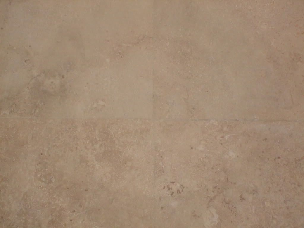

heres a closeup of the joints after finishing. If only he used a better color you wouldnt be able to see them. ALL the joints came out dead flush.

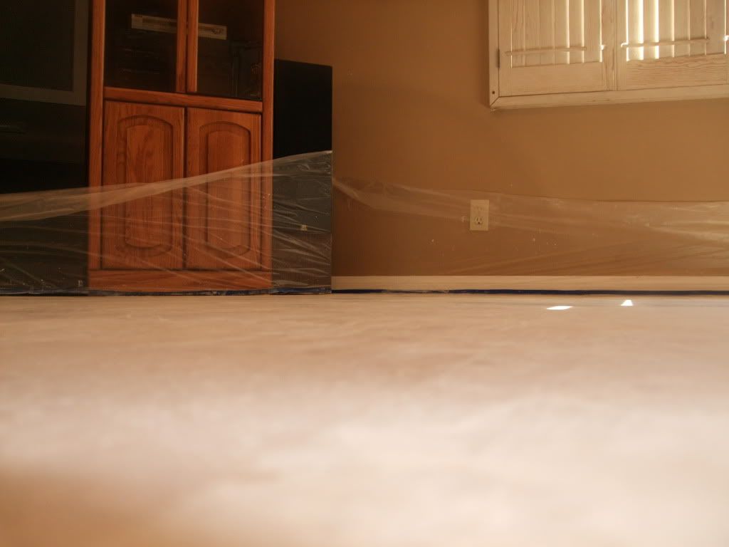

flatter than flat

Nice work Dave & Cameron .
