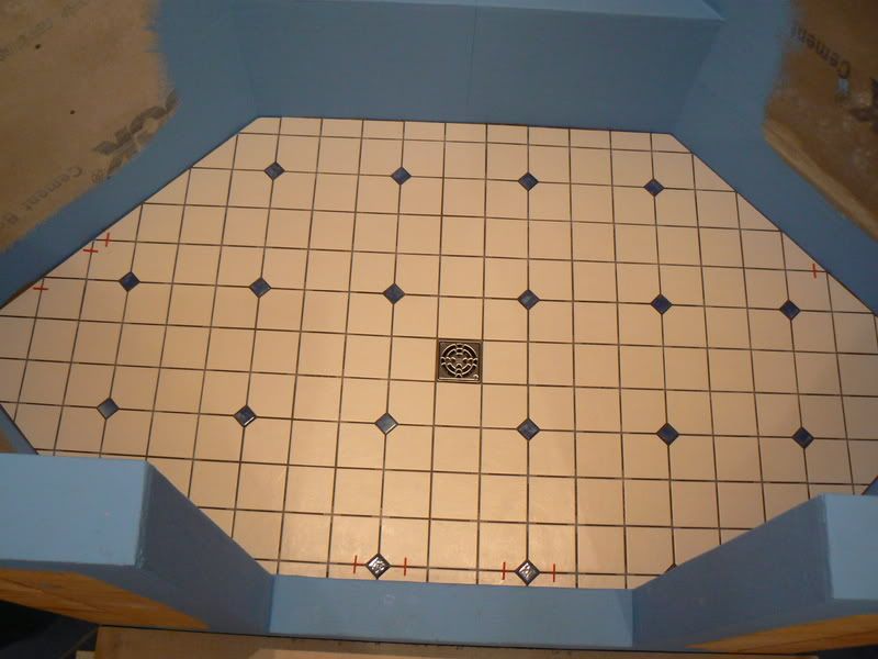

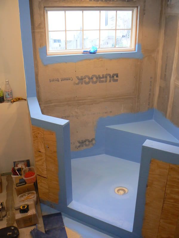

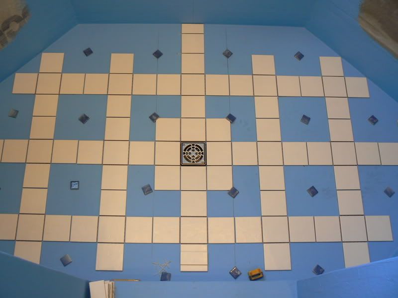

J&M- Install Cement board. Then pre-slope pan with a cement based compound (me, mapei tri-patch, with V-notched modified mortar to bond to wood substrate). Waterproofing cannot be "built up" to slope, it is a thin, "load bearing" membrane.
Actually start at your seat and work your way down and out the door. Second and third coat give durability and insurance.
Allow to dry 24 hours, then mud floor in conventional manner. If you can, after mud has had 2 days to dry apply a coat to the mud to add a layer of protection to the mud bed. As others will tell you, the Kerdi system will do thi8s in one step and be ready for tile immediately. True. But multiple layers of kerdi fabridc embedded with th8inset build up to very thick corners, one of the reasons I stick with liquids. And I'm not in that big a hurry.
[IMG][/IMG]
[IMG][/IMG]

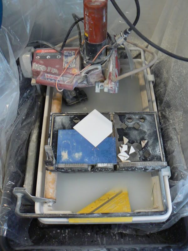

world's greatest fabrication jig-
[IMG][/IMG]
[IMG][/IMG]
anything else? Ummm, yes, that wa sa kerdi drain, they rock!
gueuze

Couple questions on your method. I presume you have a water barrier behind your cement board on the walls. What happens to the water that makes it to the water barrier? It doesn't look like you use the liquid waterproofer on the entire wall area. Since you are using the kerdi drain you don't have any weep holes that are collecting the water that the water barrier behind the board is catching.
That shower looks great by the way.
Bryan

Good question, DS. I have no answer, but I'm wondering where all this water you think is behind the wall is coming from? I'm seeing that these cement boards (durock amd permabase ) nearly repel water. Around here, I'm much more worried about all the guys using glue inside showers. How do you wrap choraloy behind a seat? I guess as a courtesy I could give the walls a once-over with the HPG for a pretty small extra fee, but it would be as more of a mold block than a waterproofing.
