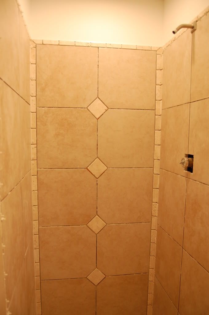

Re-doing one bathroom turned into two - as they were back to back and both needed to be gutted to redo all of the rotting copper DWV...
I'm finishing up the small secondary one first - using free leftover tile. Blew the budget on the first bathroom, lol
And yea...I roughed in the shower valve a lil off center...damnit

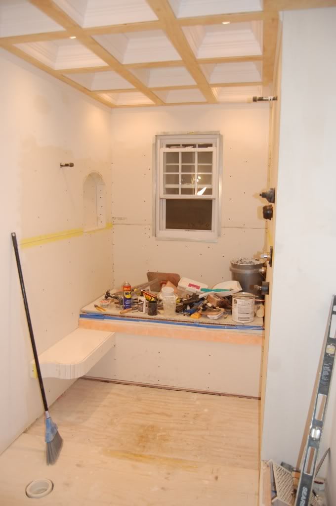

Here is the bathroom that I started this project to do - the whole room will get a continuous mud floor and Kerdi throughout. It will be a curbless 'walkthrough' shower wih a frameless wall of glass. The tub will be IN the shower area.

That coffered ceiling was a PITA, but fun..

Thanks Brian - I was about to cut notches in all 4 (8) tiles but then I realized - hey dumbass just turn the schluter drain 90 degrees and clip the corners like you would for any diagonal inset tile..notches woulda looked like crap.
As for the WD40 - I wish I had an MK, lol...just a cheapo Husky. I'm not a pro just a guy who dabbles in everything. The WD40 was for my miter saw. I took that pic after finished the 350+ piece coffered ceiling.

thanks. the coffered ceiling is just for aesthetic. It is an old concept found in alot of old elaborate buildings. Sometimes octagons are used instead of squares - especially in domed ceilings such as the US Capitol Bldg. About 200 of those 350 pcs were in the brackets I made out of plywood and glued/nailed to the ceiling.
Before I drywalled I had to furr down the ceiling with hat channel and shim all of the points where the hat channel met the joists - the joists were no where near flat and would have made getting that molding tight impossible. Think of it as a mud bed for the ceiling, lol.
oh - and I peeled off that vapor barrier because Kerdi is going on most of that wall.
