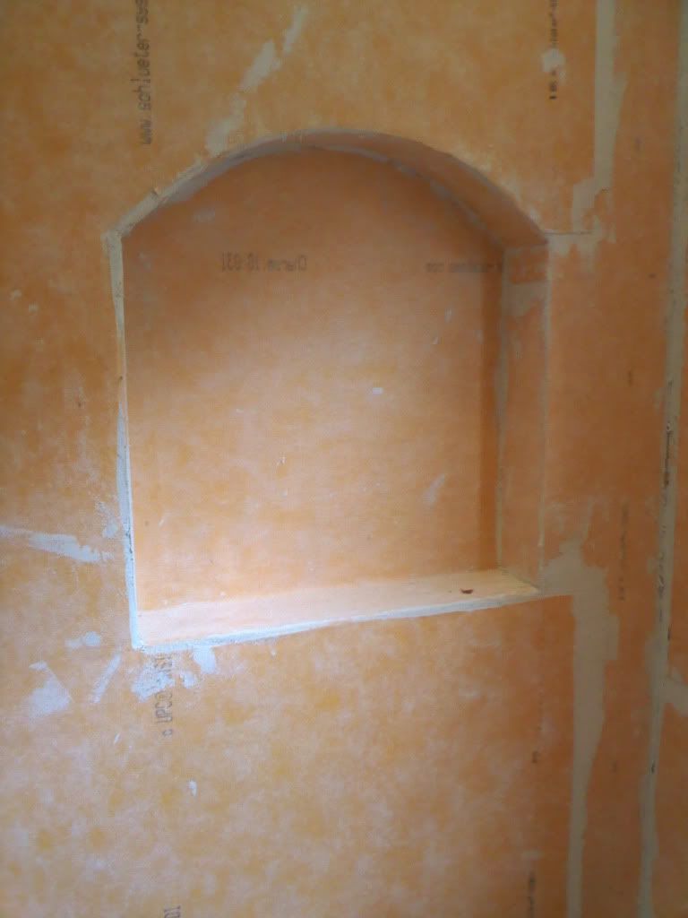

Emperador Marble Shelf?
I thought I had all of the little details taken care of - but I forgot about a shelf for the niche. The shelf needs to be 18.25" x 4", and the entire bathroom is being done in a combination of Emperador Light and Emperador Dark marbles. I would prefer Emperador Light for the shelf. The problem with just getting an 18" tile is that I think most are resin backed, also they will probably be nominally less than 18" and I need 18.25"
I'm getting slabs in Emperador dark fabbed up for the countertop and shwr seat - but those are gonna be a full 1.25" thick. Is there anything in between large format tile and pure slabs available in this type of marble???
Kyle
