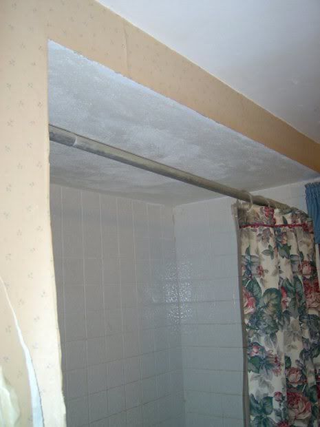

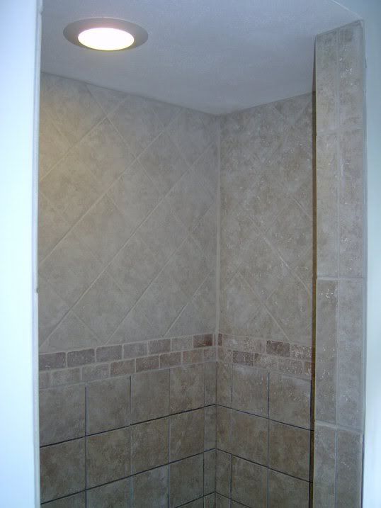

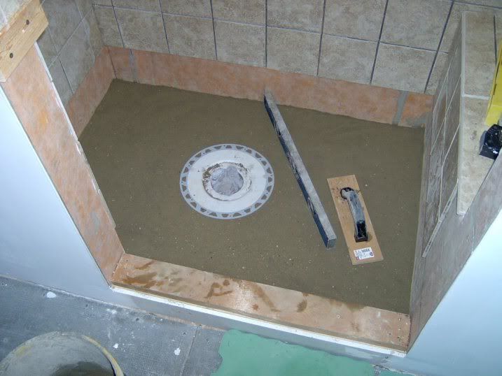

Here are some pitchers of my progress:
Before shot of tile:
Today after grouting upper half, but before final cleanup:
Mud floor put in this afternoon:
